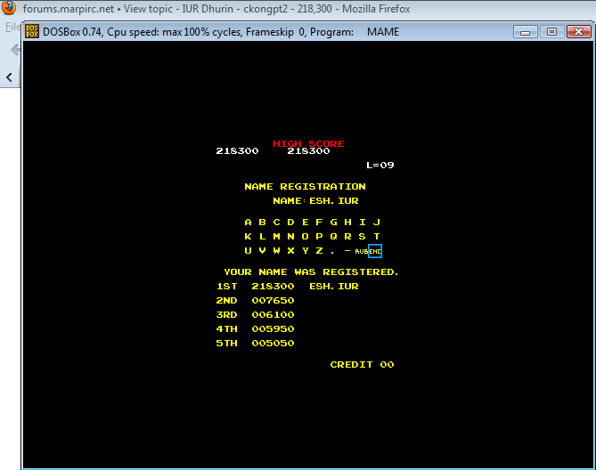

ok, finally got it to work. I tried various combos of using the inp with and without the inp directory and .inp, sometimes it would load, but wouldn't be playing back (I could insert a credit myself) and sometimes it'd show a black screen. I renamed it ckong.inp just in case it didn't like the filename at one point too. Anyway, here's what I used:
mame ckong -playback inp\ckong -640x480 (without the 640x480, it cut off the top and bottom)
Here's the result, using a screen grab of the dosbox window:

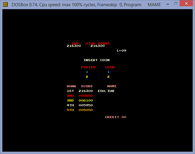

Can anybody give input on these playback issues? If so, I was able to play this back to the advertised score in the same manner as CKF.
