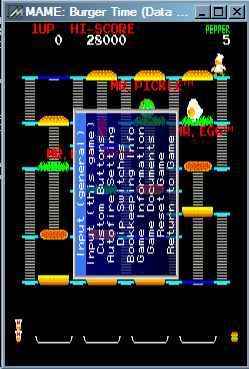

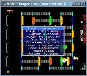

Here were the slighty disturbing print screen images when I went
wolf106.exe btime
and
wolf106.exe btime -rol
You can just remove "norotate 1" from mame.ini and it might fix issues like these starting mame rotating abnormally. When I previously investigated my mame.ini, I had assumed norotate would help resolve any issues. But the "norotate" option probably does not rotate relative to how the PCB would display it -- not how the mame program should be displaying it.

- btime.png (19.66 KiB) Viewed 4923 times
- btimeROL.png (22.41 KiB) Viewed 4923 times

I don't have mame doing anything. As I was saying, I think some version of mame between 106 and 144 (or myself messing around with rotation options) introduced "norotate 1". I suspect this setting prevents any rotation from happening by default. So if the PCB was assuming a regular tv tube was connected it would start plotting the vertical pixels horizontal. Just like burgertime's (and many other games) screen are sideways tv tubes, they would naturally be rotated when being displayed on a regular tube. The resolution is to never use "norotate" if you want games to be displayed correctly on a computer, and only use norotate if you were building a cabinet with an old tv tube.mahlemiut wrote:I'm not sure I get just what your issue is here. You have MAME automatically rotating vertically oriented games so that they are sideways? That's certainly not the default behaviour. I'd check your ini's (see if there's a vertical.ini, which is used for vertical monitor games).
