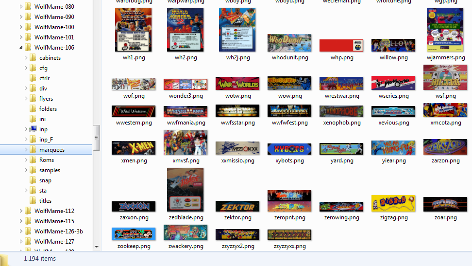

Well i dunno how it works for later versions of (Wolf)Mame, but here is my directory-tree for WolfMame106. The folders must have the names as indicated, within the main directory (tho you might be able to redefine any directories within the .ini file, i don't know):
This 'method' only works if all the files are UNzipped! Goes for all 'artwork' directories with pics.
[Again, i have no idea if this works differently with other versions of Mame.]

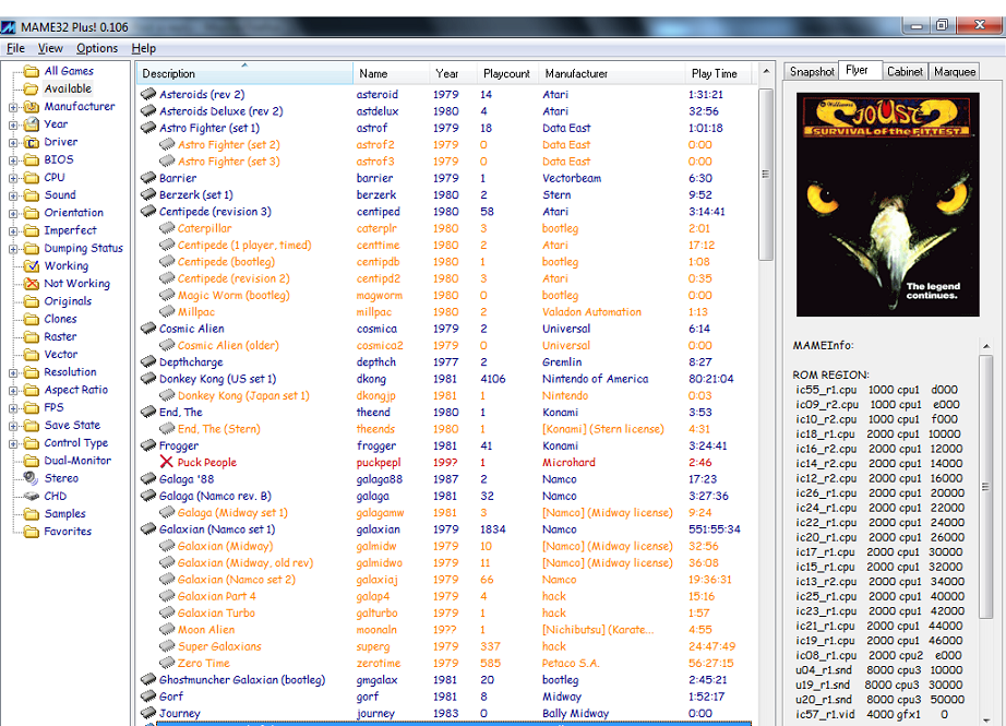

From the main gui window menu, you can choose what to show on the right via View --> Show pictures:
I've chosen Snapshot, Flyer, Cabinet, and Marquee, as you can see.
These correspond to the directories called snap, flyers, cabinets, and marquees in the 1st pic.
Most of the files only seem to work if they are .png!
Hope this helps(?) :?
