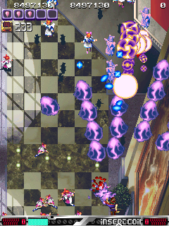

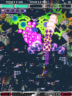

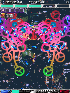

Hi :)
Butman's inp playback fine for me but only with the -window command in the cmd
Just after beginning the playback, I press F11 for the throttle and F10 to be in FS 11.
I took several snaps but not the last because i thought that i could see the hall of fame but buttman inserted a 2 nd credit (not used) which block the appareance of the hof.
I precise that in fullscreen, the game doesn't playback for me.
